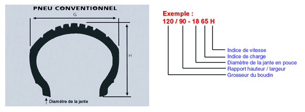

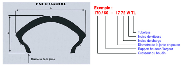

Pneus Vmax d'origine
Pour mémo :
Pneu avant.......................11O/9O V 18
Pneu arrière.....................15O/9O V 15

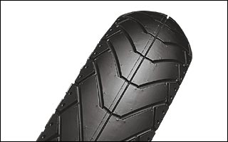

AVANT : ME 33 Laser
110/90V18 (61V) TL - 2.50 BAR
ARRIERE : MARATHON ML2 150/90B15 M/C 74V TL MBS - 2.90 BAR
http://www.metzeler.com/

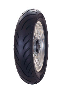

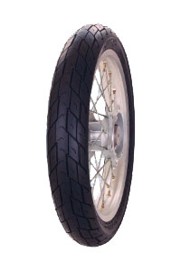

AVANT : AM20 Supervenom Front 110/90-18 61V -
2.50bar (36psi)
ARRIERE : AM42 Venom Rear 150/90 V15 M/C 74V - 2.90bar (42psi)
http://www.avontires.com/

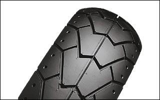

AVANT : EXEDRA G525
Front 110/90-18 61V - 2.90 BAR
ARRIERE : EXEDRA G526 Rear 150/90-15M/C 74V - 2.90 BAR
http://www.bridgestone-eu.com/
